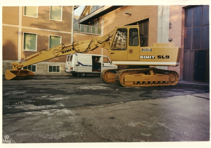

    Unfortunately I do not understand italian so I try in english. I have a great Fiat Allis SL9
    Type: SL9
    Year: 1979
    Serial: 30/382
    Engine: 004216
    Weight: 16300kg
    Manuf: Fiatallis
    It still works great but now I damage the engine and need to overhaule. Can anone help me with ientification and a link to somebody who supply parts or complete engine for change
    Thanks
    Tom
    Norway

      The engine for SL9 will be a Fiat OM CO3 I V2
      79HP/58KW
      2100 R/min
      4 cylinders
      FE and SL are two different Fiatallis excavator series... FE9 is the next version of the SL.... but there should be some differences.
      The wheeled version of SL9 is SR9...
