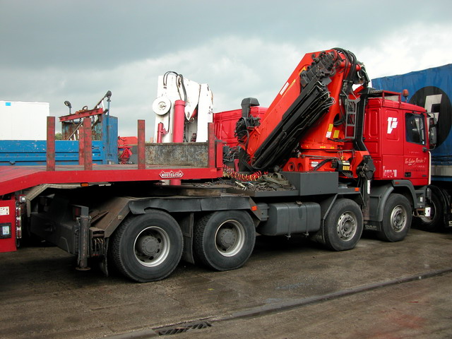

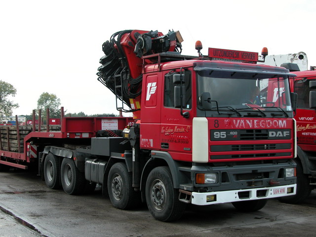

                            • Hi,
                              here is the Palfinger P750 of V. Egdom that I mentioned in the bonfiglioli thread.
                              regards
                              Harm Adams
                              • Thank you for the good pics Ditzj!!!
